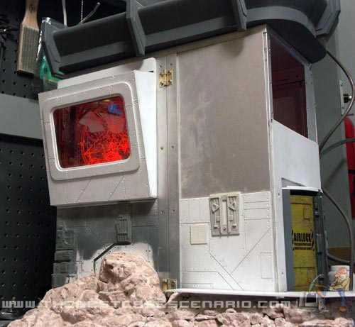

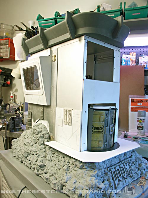

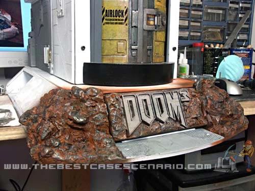

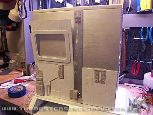

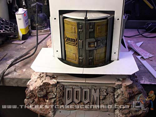

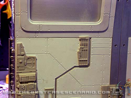

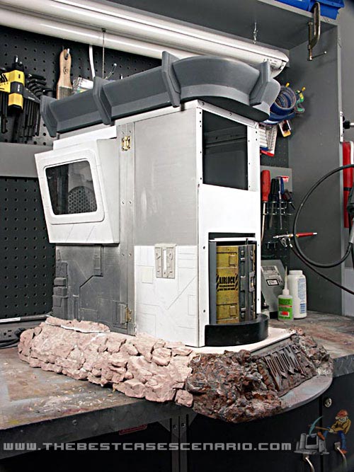

There will no doubt be a flurry of Doom3 themes this year and next, so I thought I'd add my project to the mix. Project Mars City will be fun to build with lots of kitbashing for that military/industrial Doom3 look. Expect lots of armor, mesh, lighted machinery, pressure doors, plumbing, and maybe a few sculpted animatronic beasties.

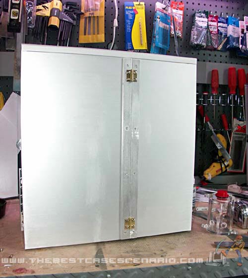

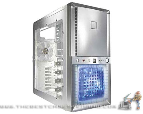

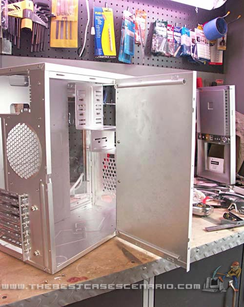

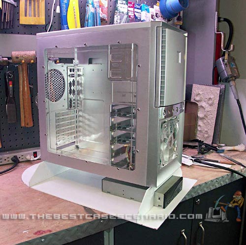

This case will be a Doom3 gaming MONSTER, DangerDen watercooled, and top of-the-line hardware and components that have yet to be determined. I have an Antec Super Lanboy to use as a base, since it's very lightweight, and the kitbashing/structural enhancements will add enough strength to this otherwise flimsy case.
Since Mashie and I are both working on Doom3 inspired cases, we set up a Live ModCam so anyone interested can see the projects as they progress. Please no complaints if the cameras aren't up 24/7--we are working on getting a dedicated server. Live ModCam

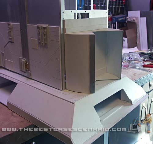

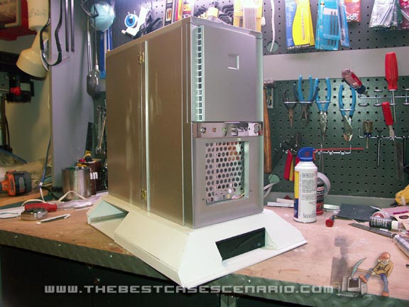

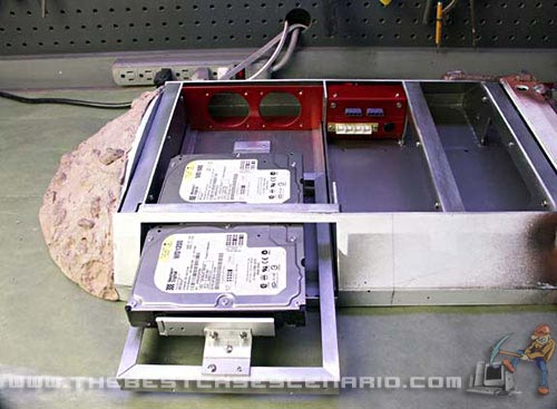

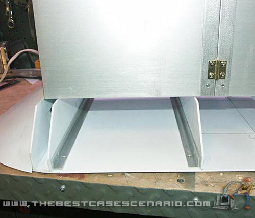

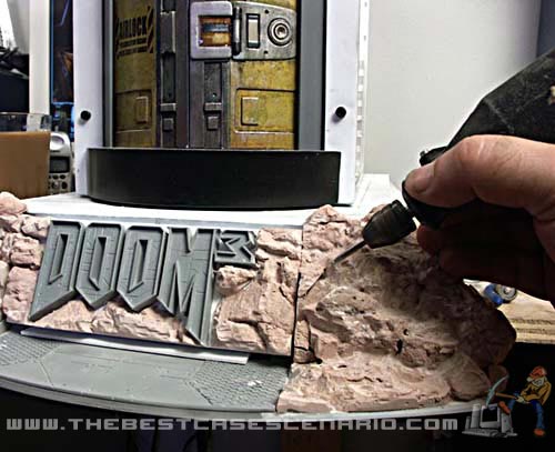

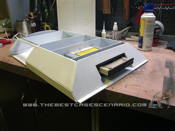

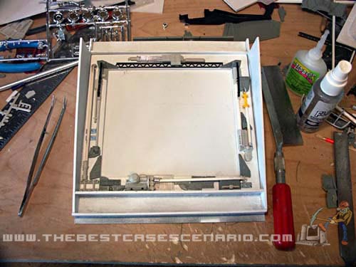

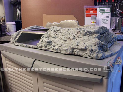

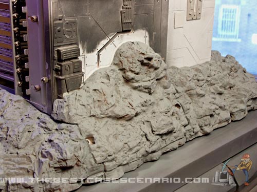

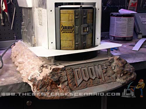

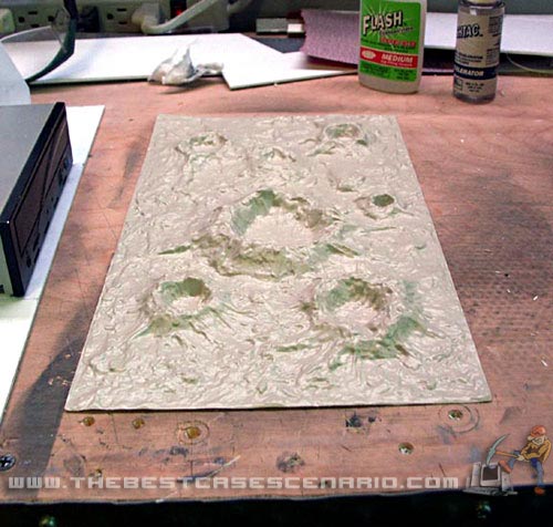

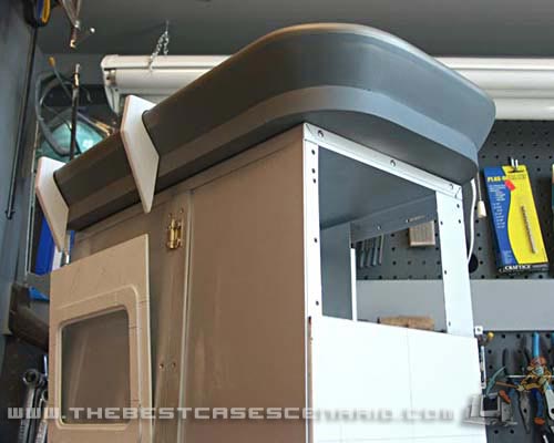

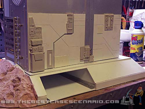

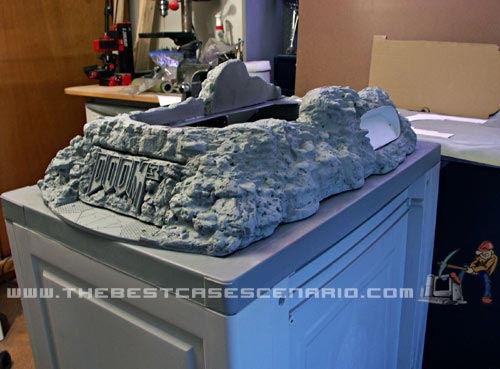

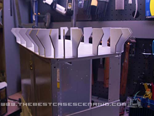

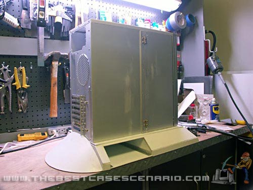

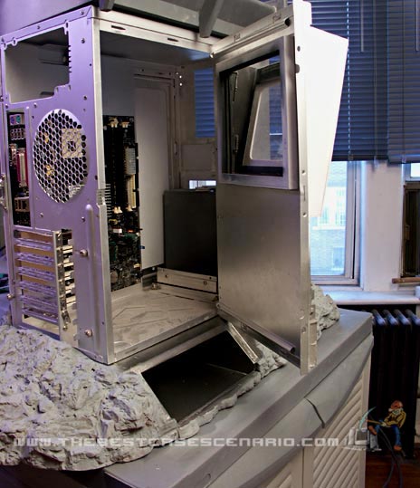

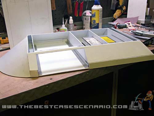

I'm making a base unit for that Antec case, with Mars terrain--i.e rocks and craters--it will also house the optical drive. I need to free up the 5.25 drive bays for the video monitor that will be integrated--probably a Xenarc, earthlcd or equivalent.

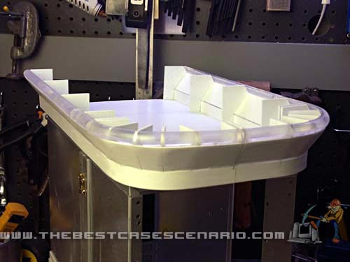

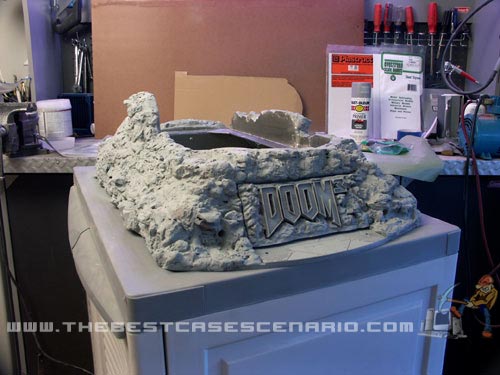

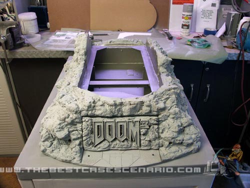

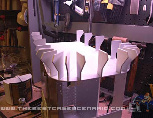

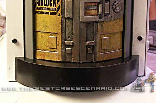

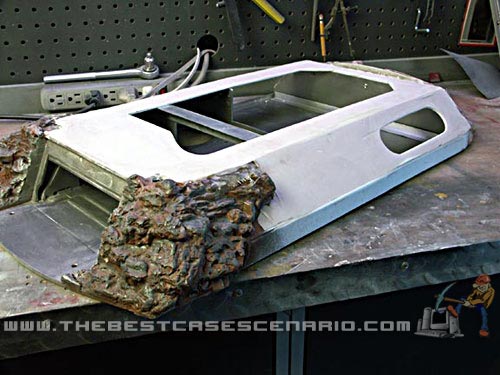

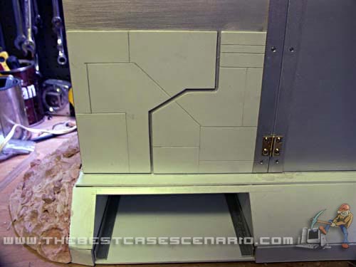

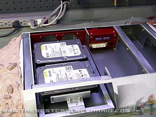

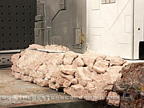

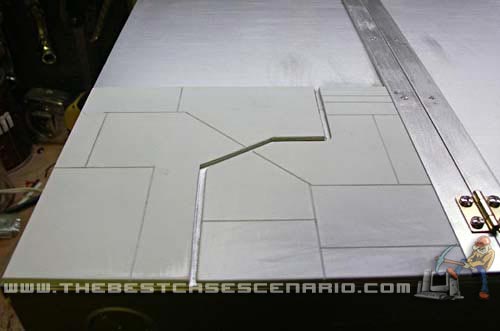

Here is the start of the base that will have a Martian terrain look. It will also house the optical drive and a few other goodies :D

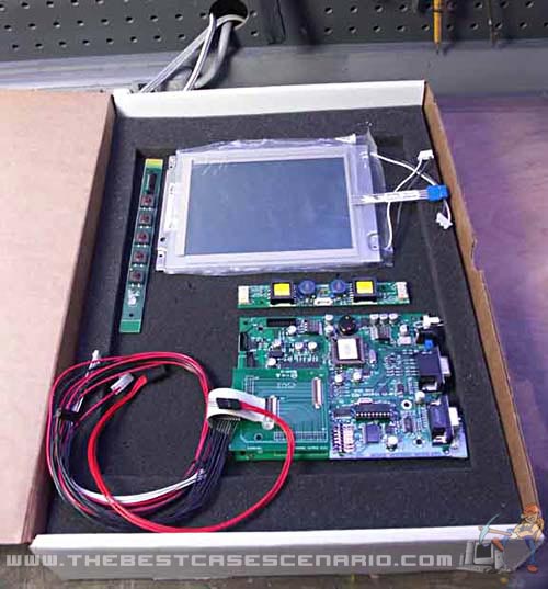

I found a motorized 7" LCD screen meant for in-dash applications. The LCD is a Panasonic OEM, so it should be pretty good. Anyone know of other brands I should look into?.
http://www.mp3playerstore.com/stuff_...al/TM-7300.htm

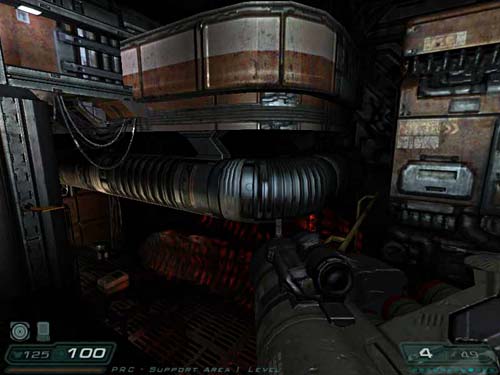

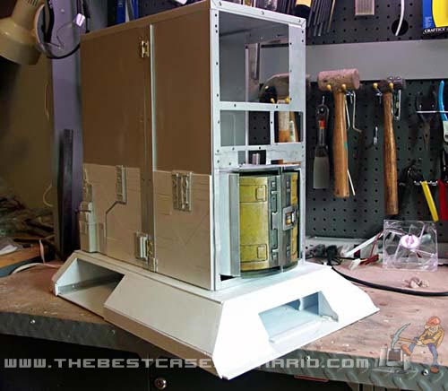

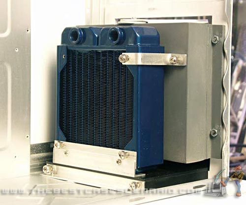

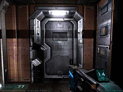

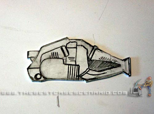

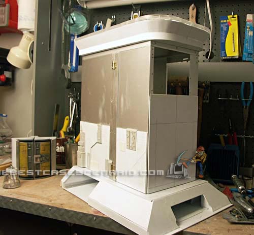

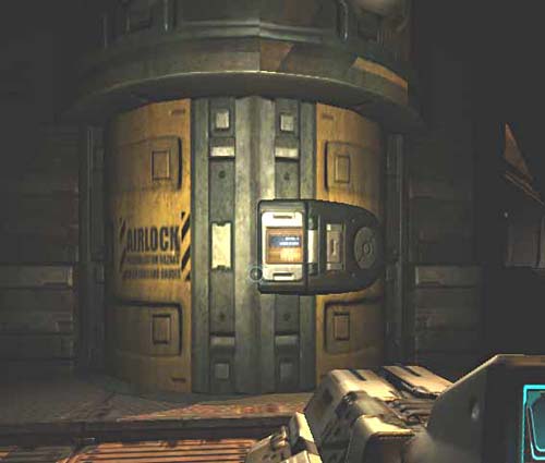

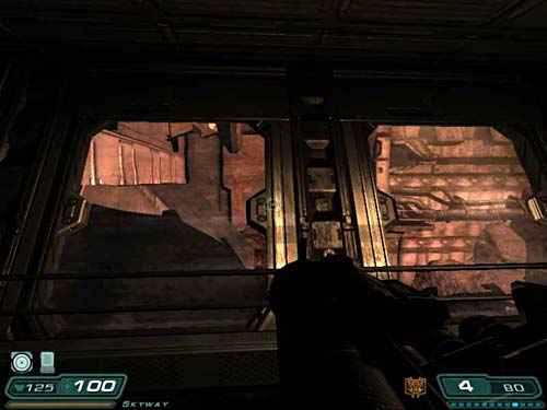

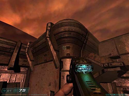

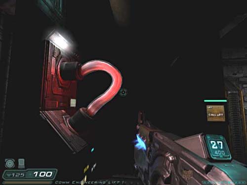

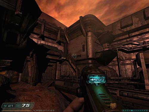

After speaking with a friend today who was kind enough to spend some time and give great ideas, i took some screenshots for inspiration. Mr. Nervous lead me in the direction of a 3/8" hose watercooling setup, so I will go with DangerDen blocks and pump for the system. There will be lots of elements from the game as far as look and feel, plus some imagination thrown in. There are so many directions a mod like this can take, but after speaking with D he thought the case itself would be cool if represented as one of the building installations on Mars, with a few water cooling parts outside the case and then slithering their way inside.

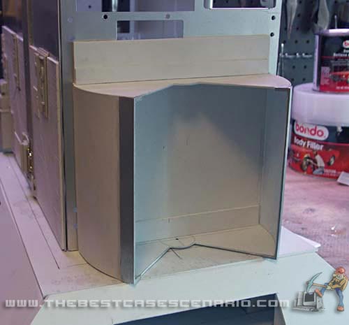

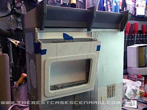

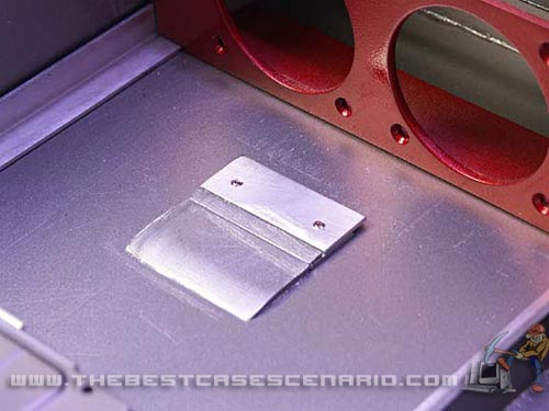

The Antec case at this point is just a shell, having popped most of the rivets and drive cages offm and will hardly be recognized once completed.
Any ideas are welcomed, this should be lots of fun to join in on! :D
