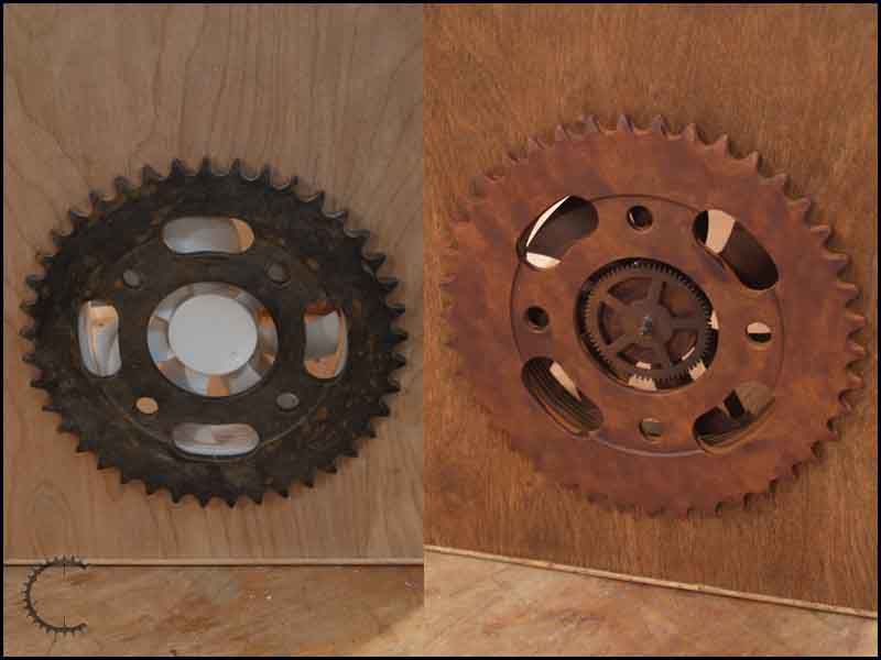

Turned out pretty well. For the front intake fan I’m using a motorcycle sprocket I picked up on Ebay. I got really lucky with this find, the measurement between the outermost edges of the outermost holes is exactly 120mm.
This build will be what I like to call pseudo-steampunk, mainly because I don’t want to be categorized, but also because I plan to have a couple of more modern elements than are normally found in steampunk work. I plan to get the look mostly from corrosion, making all the metal parts look old and neglected (most steampunk I’ve seen looks old but at least cared-for). Here is my first attempt at aging the front sprocket:
Not too bad, but not exactly what I wanted either. It’s too uniform, and actually looks more like leather than rust. It’s a start.
