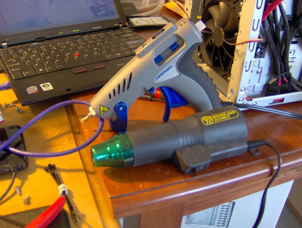

Ok, a few updates on this.
First, while I was at Micro Center to get the coolant, I finally get a tripod for my camera.
It's fairly nice; metal frame, extendible legs, and the best part..normally $8, open box so it was marked down to $6...and on clearance for 50% off, so $3.
So, now I can actually get stable shots without the flash...
A couple more tools; I finally got a glue gun, and I paid a visit to the local hobby store and found this weird little thing.
Basically, it's a small electric heat gun designed for model landscape shaping...it also works quite nicely for heatshrink tubing. Not quite as maneuverable as my old little butane torch, but a lot more dependable (the torch has been being really finicky lately).
So, with that in hand, I finished up the last of the wiring (for now). ..ignore the blob in the top left, that's gonna be replaced in the not too distant future.
Now to start it up and see how it does with the new equipment.

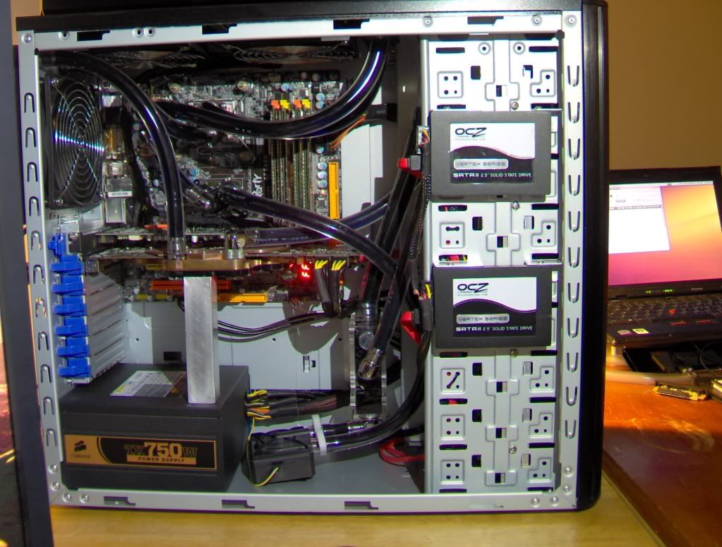

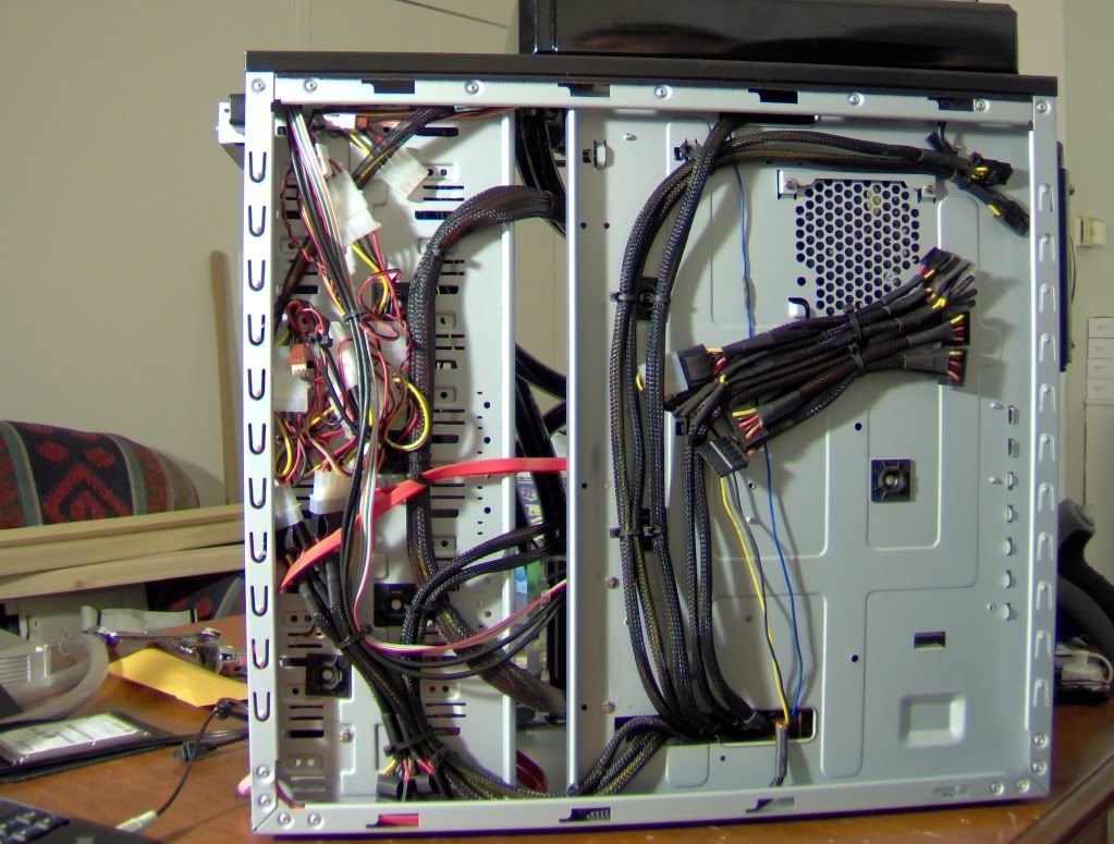

Ok, first, I don't think I've posted a shot of the interesting side of the interior yet.
Here ya go (the aluminum bar is because I noticed that my card was actually noticeably bending under the weight of itself and the waterblock...I'll be replacing that with something a little more...in fitting with the theme...later):

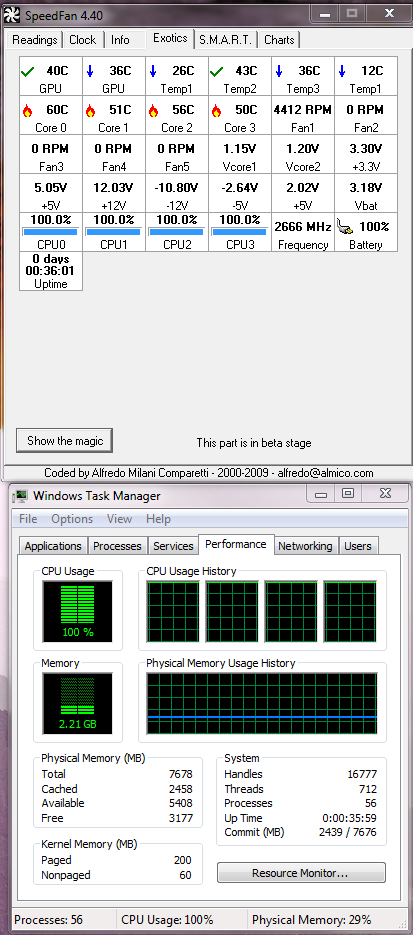

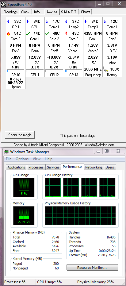

Now then, I've got it up and running now, and I'm quite impressed with two things:
1) The noise level. I think I mentioned this when I was testing the loop, but the loudest thing in this system now is definitely the pump. Has anyone tried undervolting pumps? I'm sure I don't need the high level of flow that I have, and if I could knock a few hundred RPMs off it, I'm sure it would be quite a bit quieter.
2) The temps! Ok, so they're actually slightly higher than before, but keep in mind I'm moving half the air that I was before!
old:
new:
idle:
load after 10 minutes of prime95:
Keep in mind also, that except for the first GPU temp, this is all temps with new AS5, so after a week or two everything should drop a few C.
Seeing these temps, I think I will invest in 6 more fans to set up a push-pull arrangement, but even then I doubt I'll be topping 30dBA. Maybe below 20 if I can turn down the pump!
I gotta say, all that aside, it is soooo nice to have my desktop back in working order again. It's been, what, 2 weeks?
Well then, right now I'm gonna clean up my desk a little, then put in some long overdue time working on my Borderlands character. Gotta get it ready to take on General Knoxx!

Nice...gotta love Micro Center's clearance stuff. I miss being within driving distance of one. I used to work at the one in Santa Clara, CA, but now that I'm near LA, the closest one is 2 hours south in Tustin. Oh well.
I like the heat gun - I need something for heat shrink tubing (been using electrical tape, then cover that with scotch tape since electrical has an annoying tendency to unstick over time). But I also will be working on model landscaping...two birds with one stone, so I'll have to check out my local hobby shop too. And I love the aluminum bar. Well, ok, I know it doesn't really fit in, but I've jury-rigged a lot of stuff like that in my own case over the years. You know, "temporary" solutions that end up being semi-permanent.
I've never tried undervolting a pump before, but I'd imagine it would be easy enough to get a resistor to knock the voltage down a few notches. Actually, come to think of it, you could probably use a fan speed controller to do it. They're usually designed for 12V connections and then you could manually control the pump speed. Dunno if that's good for the pump though, but then again, it would be unique.
It took me a bit to find this one, it was kinda tucked into a corner behind the trains. ..though I suppose I could have just asked someone..

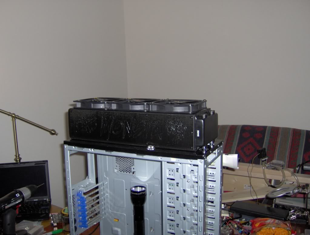

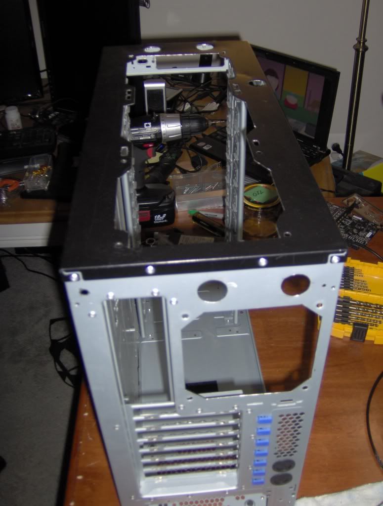

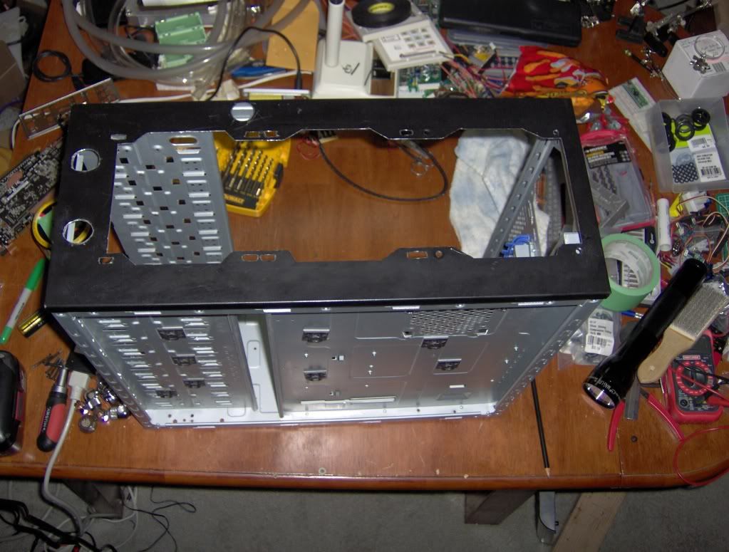

Since I was going from a 140x2 rad on the roof to a 140x3, I obviously needed to make the hole bigger. So, several hours of measuring, grinding, fitting, re-grinding, etc later, I had this:
Nice big hole for my new rad.
Monsta fitted to roof:
That was Thursday night. ...a looong Thursday night... I didn't take any pics of the semi-finished product then, but it's mostly like it is now except for the wiring bits I did today.
To make the wiring to the fans up top more sane, I'm combining them all into a single line that'll then run down through a tiny hole in the back of the case. A side benefit of this is that I won't have to tear apart my fan power splitter because now I'll only have 12 connections!

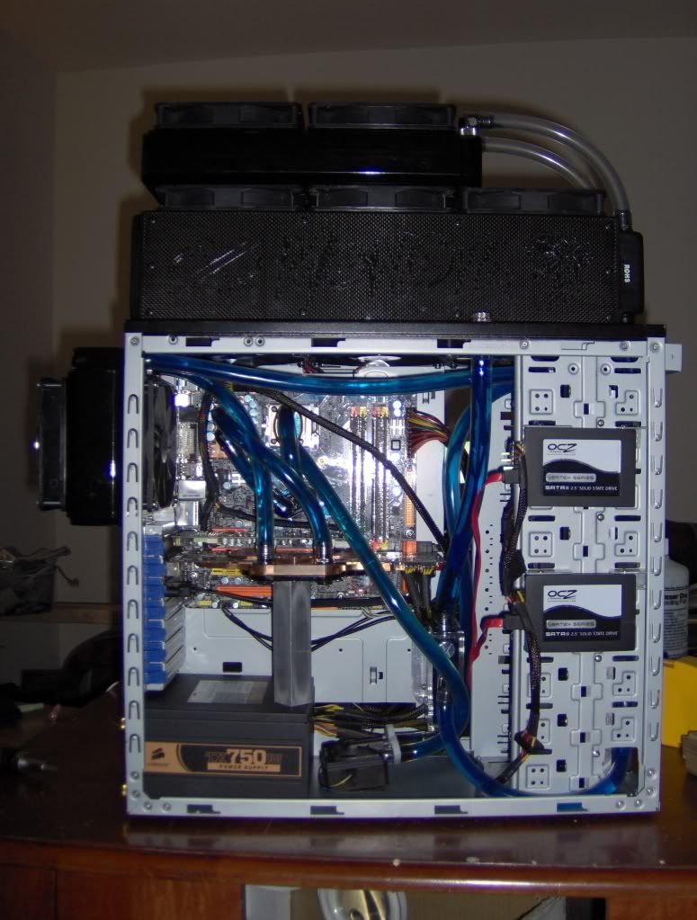

And the finished product (for now...it's still far from finished, but I'm waiting on some tubing to redo the loop to pull the two top rads into series):
Ok, so the good news is that my GPU was just fine! I just forgot that if I plug anything into SATA ports 2 or 3 on my MBB, that the PCIe graphics stops working...I have no fsking clue why, but it does, and I only need 3 of the 6 ports, so I ignore it.
Bad(ish) news is that my idle temps are exactly the same as they were before When I redo the loop I'm going to lap my CPU, and hopefully that'll take care of that part anyways.
/shrugs
