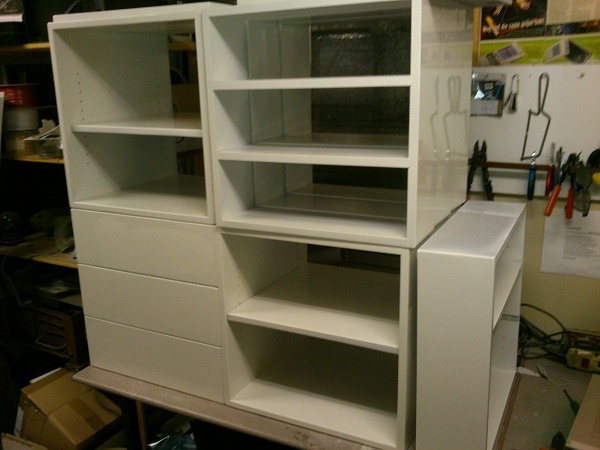

    It has been a while, but I'm in need of some extra space in my garage, since i'm doing the final steps at the audio/video furniture:
    So it's time for final assembly before putting in some hardware I'm happy with the November MOTM nomination, especially by keeping in mind that this case is more for practical use, and less eyecatching compared to the others.
