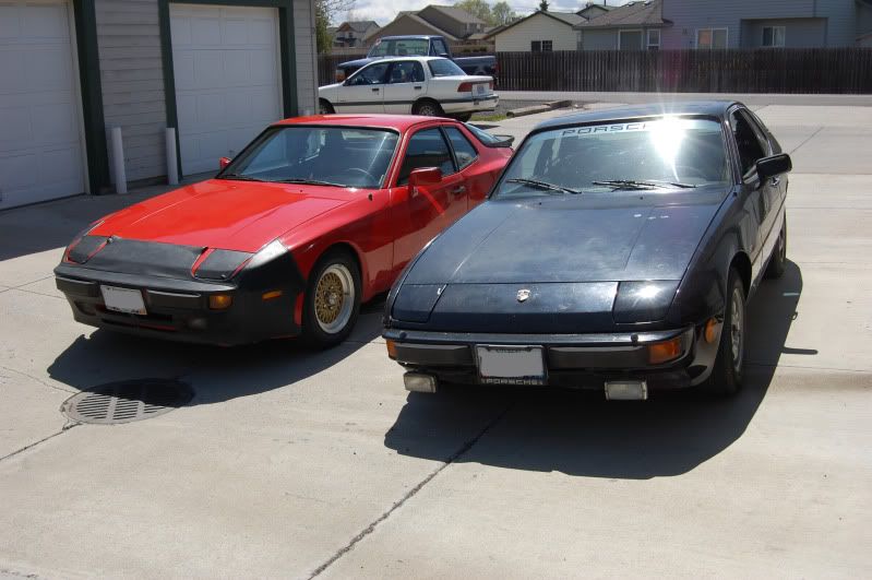

got a parts car.
The good news - got the engine running and turning over today. LOTS of parts on it are in insane condition. Before it was parked the engine apparently had been replaced on almost all of the CIS parts. Almost all of them are in immaculate condition. The fuel system was my biggest concern and I am IMPRESSED.
Tranny is great, torque tube is in awesome shape and the engine is better than I could expect. Mind you the rest looks like pure ass.... this would have cost the same as my parts budget for a while, so I won't complain since it was FREE!
My this car rest in pieces when I'm done parting it out. I feel bad that it lived such a great life to come to such an end, but this car would take a small army to get it back on the road.... it will serve a great cause :)
Stay tuned.....
