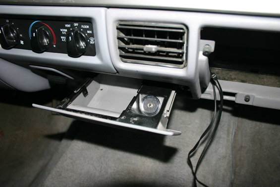

First, was to take the ashtray outta the dash. Easy enough.

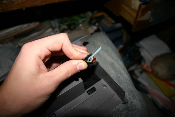

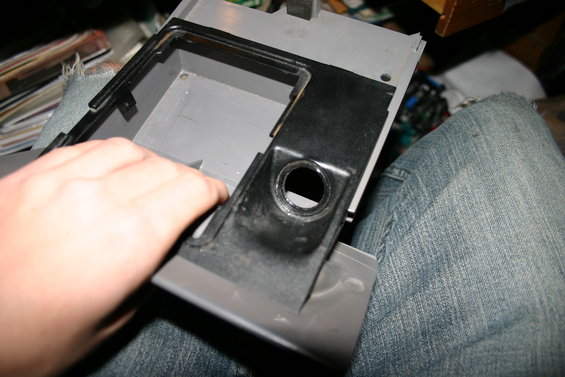

Here's the PO's handiwork (I swear that's spelled correctly)
Stripped down.

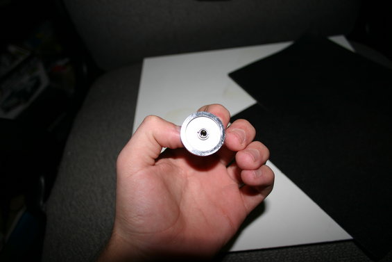

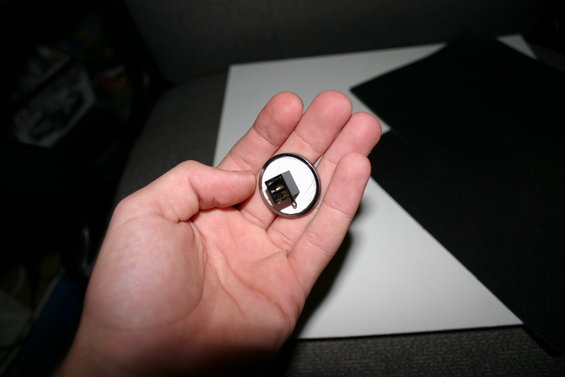

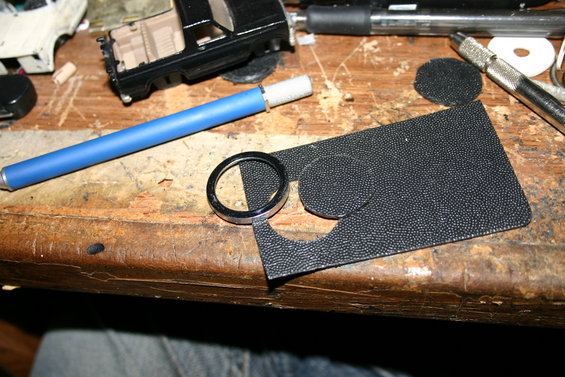

Here we have two types of plastic. Styrene and something I pulled from a laptop bag (used to stiffen the bottom). The styrene is thicker than the black stuff and is smooth, but the black is textured and looks like something an OEM would use. Also shown is the metal ring off of the socket as well as a cheap Radio Shack stereo jack from an unfinished project.
Test fitting. Looks good front and back.
Stuck in the tray for looks. I wonder what it looks like in black?
Textured plastic.

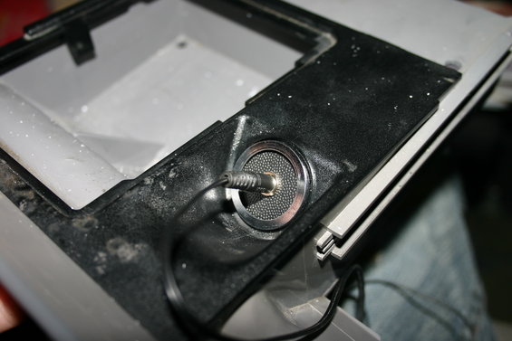

Put together.

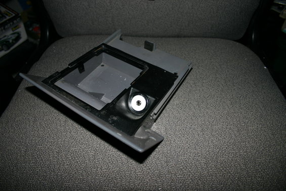

In place.
I epoxied everything together so it wouldn't pull out when the cable was tugged or unplugged.
It works! Time to put it in the truck.

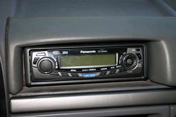

Here's a quick pic of my head unit. Nothing fancy, it does what I need.

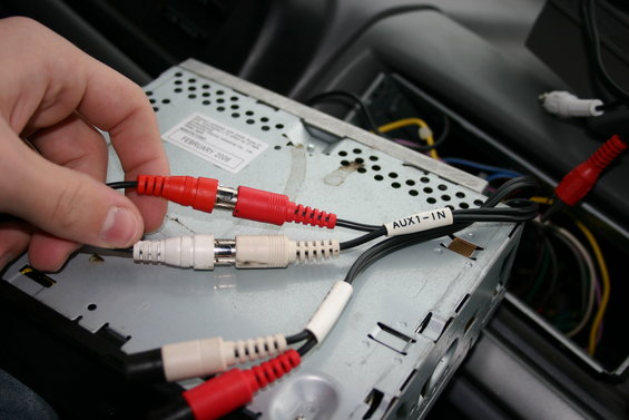

And my under dash rigging. I reused this bit by cutting the end off and soldering it to the the 3.5mm stereo jack in the tray.
The auxiliary cables
Here's the ashtray reinstalled.
The excess wires are zip-tied together.

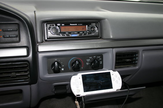

And here is my PSP plugged in (yes I still use one of these things!) and playing through the truck's speakers.
